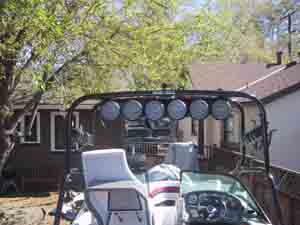

I definitely want it to sound right. The installation is in a custom fiberglass box for my wakeboard boat tower. I tried attaching a pic but it's way too big. I have not ordered the crossovers for the horns yet but will be. I'm just waiting for the recommendation from the mfgr. Assuming I go with this set-up (including the crossovers), how would you recommend I wire it?

Help wiring these speakers. -- posted image.

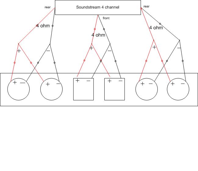

Is the drawing the same of what you're recommending? (square's are horns and rounds are mids) I think that would have all of the speakers running at 4ohms and only 65 watts to each or am I doing something wrong. I have 4 Image Dynamics IDv.3 8" subs for the bass so I should be ok there. Thanks again.Help wiring these speakers. -- posted image.

No, I'd run the horns at 8-ohms, one to a channel, not bridged in parallel.

Oh yes, I missed that... Am I correct with watts per each mid? 65? At ohms, how many watts would I be getting to the horns?
