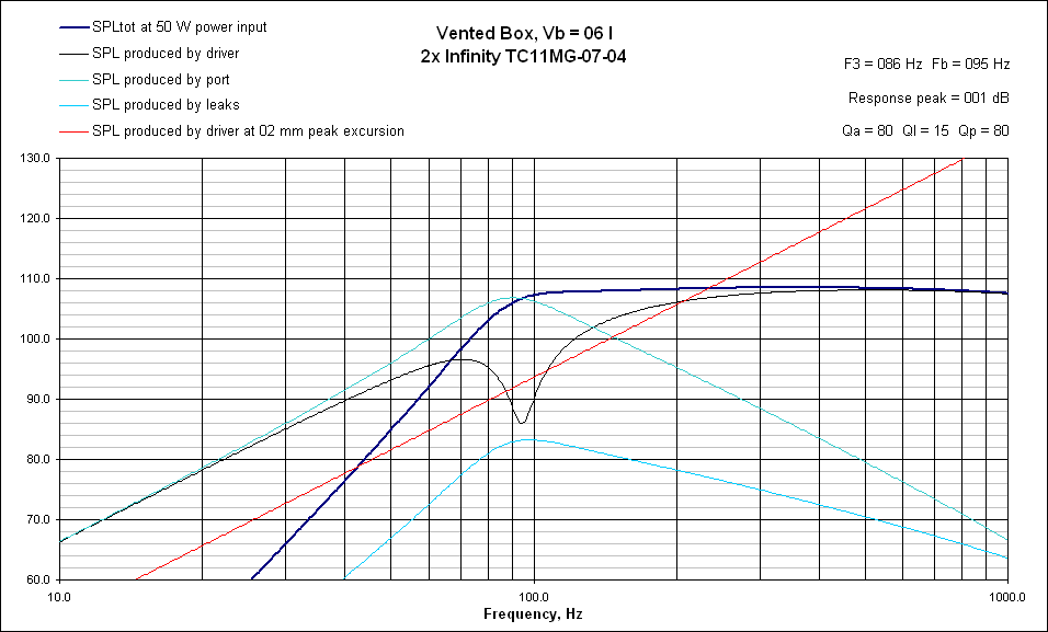

You're welcome and I'll add this visual of what the port tuning does using a little project  I'm currently working on.  You'll see in this graph that the driver output is represented by a black line and at one point it dips low because of driver impedance.  The port SPL is represented by a turquoise line and at that same point it peaks.  The combination of everything together is shown in the final result by the heavy line, which is a smooth output and an extended low frequency for this driver.  The WinISD graph gives you a combined representation of output but doesn't break it down into separate responses on the same graph like this does, but you can use the WinISD program to see the same end result.  This graph was generated using Unibox.
