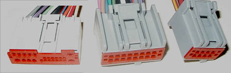

And the actual harness you would need I believe is the Metra 71-5520-01 which comes with the radio harness, OEM DVD overhead harness (which you wouldn't use), and the subwoofer harness.
2005 Ford Escape subwoofer -- posted image.
