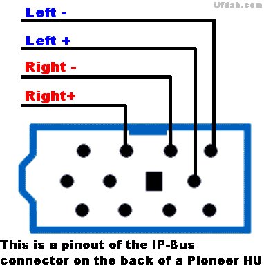

A friend of mine has asked me if it was possible to use the shuttle (square blue) input of his old pioneer deh760mp, for an auxilary input, by getting the pin-outs for it and making up a plug that supports rca input. Is that possible or is there some other way?

yes first of all, program you radio for AUX input and splce the p-bus plus with 2 rca's to the correct pins.

or just by the PIE or pioneer aux input adapter avaible from many places such as crutchfield

Hey Bnluis, many thanks for your quick reply. I really didn't expect to get the answers I was looking for, but to my surprise I found EXACTLY what I was looking for. Never again will I underestimate the power of the 12V Forums!

no problem Pioneer DEH-760mp aux input? -- posted image.
