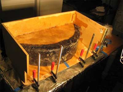

This is just the mold I am using so that I can do the layup outside the car, so ignore the air bubbles, they won't be a part of the enclosure. I thought about using this as part of the enclosure, but decided that I didn't want the extra weight of all the MDF.

So you're going to be making an enclosure that fits over your spare tire, but still in your spare tire well. If thats not it thats still an awesome idea. If you can get your air space to work.

I should be able to squeeze 1.1 ft3 per sub while still having access to the spare. The open end toward the clamps will have another piece (not pictured) that will fit flush against the seat (it's just easier to make the mold in parts due to the angles). In front of the enclosure I will be putting in a amp rack that holds one on top and one underneath (sort of an H-shape), and I will raise a false floor on both sides with ~.75 ft3 compartments for tool storage. With everything in place it will leave just about enough space for a pack of gum or pack of cigarettes (these cars have a very pathetic excuse for a trunk -- I've still got a Saturn wagon for parts-hauling and trips to the airport so I really don't mind though LOL).
On a side note, one idea I am playing with is taking the finished casting and coating it inside and underneath with RTV silicone (room temperature vulcanizing) to cut down on resonance and any panel contact -- anyone ever try this?
