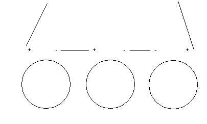

This is the way I was thinking of doing it. Is this 4 ohm? I will be running this bridged on the subwoofer channel of a blaupunkt amp, that is 2ohm stable. Am I good to go, other than it posssibly being out of phase?.
series parrallel for 3 subs -- posted image.
Paul
The right-most speaker in this diagram is wired backwards. The positive terminal should be to the left, then all the speakers will be in phase.

Sorry, Paul and Paul.  It's still 12 ohms but now you've got one woofer out of phase....you might as well run just one woofer as to do that.   Your best bet is to do what Alpine (aka Clarion) Guy said to do.
Here's the math for figuring series:  R total = R1 + R2 + R3 etc.
               for figuring parallel:  1/R total + 1/R1 + 1/R2 + 1/R3 etc.
In the diagram you have no woofers wired in parallel.  You have to have at least two SVC woofers to make either a series or parallel connection.  You are showing three subs in series, but one is reversed.  There is no magic that will help you.  Here is a handy wiring wizard.

I didnt even notice that. You are right. Other than that am I ok?
