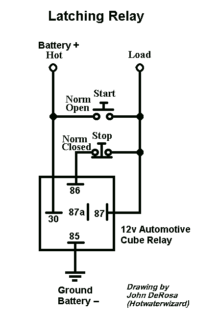

Sounds like one of the wires is hot all the time. That would confuse me too. Here is a latching relay circuit.
Fusebox power relay? -- posted image.

Thanks for the reply John, I actually don't want it to latch, or stay on.
<<Sounds like one of the wires is hot all the time.>>
30 is hot all the time. 86 is hot only when the car is on. When energized, 30 hooks to 86. When 86/85 is de-energized I wanted it to cut off power from 30, but 86 stays hot. This is the part I'm trying to prevent. 86 should be hot only when the car is on or in ACC.

I know you don't want a latching relay .I posted it so that you could study it and figure out how it works. I think the coil of the relay may be latching from a draw of power from the lights. You may need to stick a couple of Diodes into the circuit to stop the latch action.

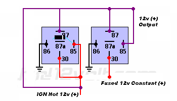

John thanks for the diagram. I took one from this site also and modified it...can you give me your opinion? I am still trying to accomplish the following:
-Have the IGN hot circuit activate the left relay
-The left relay activates the right relay (which is meant to serve as a power relay)
-The right relay sends full 12v via thicker gauge wire right back into the IGN hot circuit
-When the car is off, the left relay should de-activate thus shutting off the power relay on the right as well
Will this work as described? Thanks again...

I think I answered my own question...it won't work properly that way...
