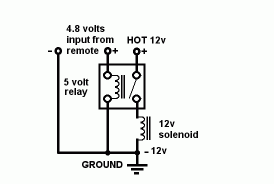

I require the remote activation of a relay which in turn will activate a 12 v pull solenoid.  I am using the control for a model airplane to send the signal to a receiver.  The receiver will output a 4.8 V signal which I want to activate the relay.  Can anyone advise me on what type of relay (circuit) which I can use where I will combine the 4.8v output and the 12 v from a normal battery on the same circuit?

Remote activation of relay -- posted image.
