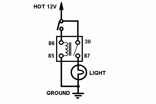

Hi would like to know how i can wire up a relay with a switch to turn on things like my Dash Display, and other 12v accessories in my race car. would it be better then just hard wiring it to a switch direct to the 12v source?

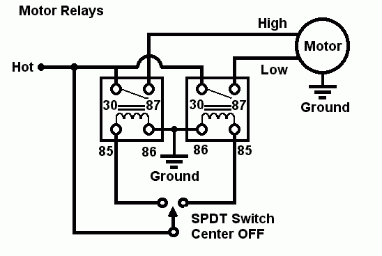

Also what is the best way to wire up a window wiper with a relay?? the wiper motor has 2 speeds would it be best to wire it with 2 relays?

Posted: April 16, 2005 at 3:48 PM / IP Logged
Using Relays for various items -- posted image.

popeye004
Copper - Posts: 97
Joined: March 08, 2004
Posted: April 16, 2005 at 4:30 PM / IP Logged
there's a good diagram.

Posted: April 16, 2005 at 4:44 PM / IP Logged

ff-mike
Copper - Posts: 199
Joined: November 15, 2004
Posted: June 07, 2005 at 4:05 PM / IP Logged
John- I am not sure in his application, but in the past my wipers have been 4 wired- ground, low, high, and park. Otherwise it looks as easy as you msde it
