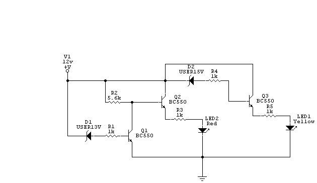

Does anyone knows at what voltage a relay cuts out? I want my generator to start in my toyhauler at aout 10.5 volts. Any lower voltage and it will not electric start. Does anyone know if I use a normally open relay if at around 10.5 volts the coil would de-energize and close the contacts allowing my generator to start? If not, anyone have any ideas on another way to do this?

You could try to modify this circuit.
Low voltage relay? -- posted image.
