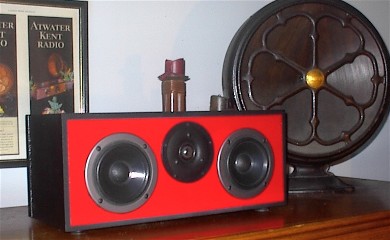

With PartsExpress, I always look at the buyouts first and figure what I can do with those.  I put $6 Vifa-JBL woofers in my rear dipoles and $4 Vifa-Infinity woofers in my center channel....and bought 4 extra of the latter with the thought of using them in some new main speakers that I will be starting on (when my wife's not looking...).  I figured that since I was just learning while doing I wouldn't have a ton of money in speakers and I am happy to report that both buyouts turned out to be perfect for the task.  I'll probably graduate to the Morels when the day comes that I'm brimming with confidence!
BTW, DYohn, I finished up that center channel and it rocks.  I used a Tang Band tweeter with the two Infinitys.  I'll hijack Ravendarat's thread and post up a pic.  (Sorry 'bout that, Ravendarat...)  I still have a long way to go on cabinet-making, though, but I'll be getting a router sometime soon so I'll start learning how to flush-mount the drivers.

Steve, flush mount that tweet and you'll notice an improvement in time coherence.  Good work, BTW.  I like your red and black scheme.
