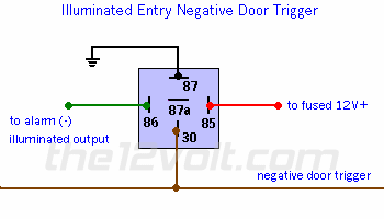

The domelight supervision output is only 200ma.  You'll need to use a relay to send a negative signal to the White wire at the underdash light.  Here's how  :
dome supervision work around -- posted image.
