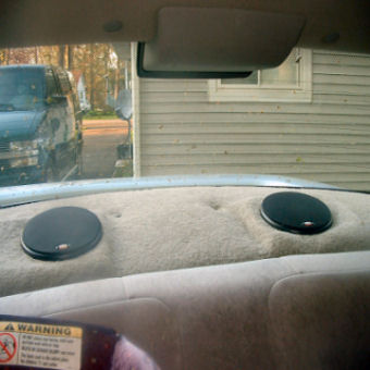

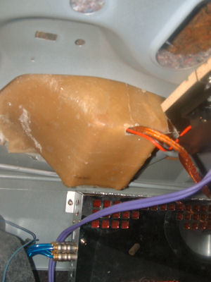

I myself removed the 6X9 mounting plates from the rear of my Lumina Euro, built a set of adaptor plates out of 1/2" MDF then (using an old 6.5" that I had laying around), fiberglassed and actual enclosure for the rears. They sound much, much better.
