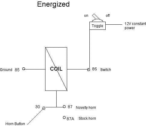

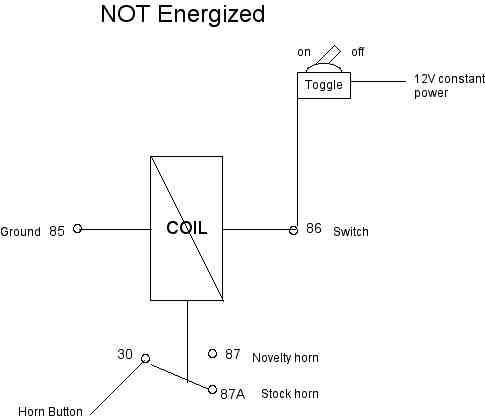

I'd like to run a novelty air horn from my steering wheel button but switch between that and the stock one with a hidden switch under the dash. Do these diagrams look correct, it seems relatively straight forward but I could be totally wrong. I appreciate any feedback.

Your diagram is wired correctly and will work as planned.
You don't necessarily have to have the toggle switch on the +12v constant power line. You could also change your diagram and put the toggle switch on the ground side and the relay would still work the same.  I only say this as a suggestion if it will simplify the actual wiring.  It would depend on where you mount the relay in relation to the constant power source and the toggle switch location.
