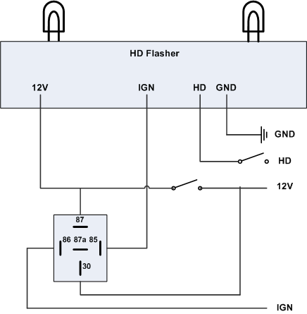

I seem to be talking to myself. But either way, here's my try on how I could do this in the diagram below. Would this work ? Are there any issues I'm not covering in the diagram below ? Do I need any diode isolation ? Is it any issue that when the led switch is on, the engine is on, and the headlights are on, there are two paths for 12V constant, i.e. direct through switch and direct through relay ? Feedback appreciated.
This is what the flasher module does:
                             HD On                         HD Off
Engine Off              Flashing Light           Flashing Light
Engine On              Constant Light          No Light
This is what I want:
                              Switch Off / HD Off    Switch Off / HD On    Switch On / HD Off    Switch On / HD On
Engine Off              No Light                       No Light                      Flashing Light           Flashing Light
Engine On              No Light                       Constant Light          No Light                      Constant Light
This is how I think I can accomplish it:
Varad LED Flasher -- posted image.
Any input ?

vseth,
My head hurts, I have to take an Advil and think about your questions. It's a very simple setup to begin with, but you have made it just that much more complex when you introduce a certain feature that is not there to begin with.
BTW, you can hit the EDIT button and add anything else you have forgotten. This way it's a lot easlier for anyone answering your questions to see everything on one post. + it doesn't sound like you are answering your own post. Too late now because I have posted. But just for further reference do that the next time.

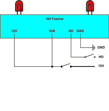

Just tie the one that sayes IGN to the Hot Lead and you are Done.Varad LED Flasher -- posted image.

Could it really be that simple. If so that's great, but I suspect I will not be able to make it flash, in which case it becomes same as connecting LEDs directly ( i.e. without the flasher modules at all ). Plus will there be any requirement for diodes on the ignition and 12V wire connections ? Any possibility of shorts ( maybe internal of the flasher between the 12v and IGN ) ? Here is what I suspect
Engine Off              No Light                       No Light                      No Light                      Constant Light
Engine On              No Light                       No Light                      No Light                      Constant Light
The module will always presume that the ignition is on, and as such will not let the LEDs flash. Also when I turn the HD On, ofcourse the normal headlights will come on as well ( which I would not want when the engine is off ).  There's dependancy on how exactly the logic inside the flasher module is set, so because of the simplicity I will definately check how it works out, if I connected that way.

You could make it flash by adding another switch between the hot ans IGN wires. open it flashes closed it does not  12v off nothing happens.

Great idea. But I'll have to test out how the module reacts to that, cause it's dependant on it. Example if you just connect the ground and 12V wires, all it does is flash, like an alarm LED. But I think, it'll work. I'll follow-up. Thanks.
