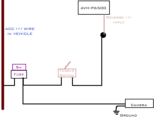

Rear view camera switch -- posted image.
Camera is always on when the vehicle is on, flip the switch and the unit thinks the vehicle is in reverse. I believe this is how your asking to do it? Only change I would make it run the camera positive lead to the same side of the switch that the pioneer unit goes to. That way the camera is only on when you flip the switch as well. Saves the camera from being on ALL the time. No need to keep it on when your not using it.

Wow, thank you for this diagram, Mike. I'll try it out today and let you know how it goes. I appreciate the effort you put into making me a diagram, very kind of you. And you're right, I should probably change the camera to only on when I need it. No point to wearing it down all the time when it's not even being used.
On final question, please. On your diagram, you put Acc + wire in vehicle. Can this be any old accessory wire, or should I tap into the one on the ignition harness under the steering wheel? Thanks again.

Well, I tapped into the accessory wire I ran for my alarm and did the fuse and switch like you told me. It works great! Thanks a lot for your help.
