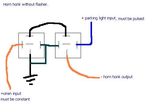

My OEM horn wire is : GREEN/ BLUE (-)located at the STEERING COLUMN HARNESS. If my output wire is a + how will I connect the horn(-) wire? Is there a horn(+) wire in the steering column? What color? thanks.
auex
Platinum - Posts: 5,041
Joined: December 23, 2002
Posted: June 01, 2005 at 11:40 PM / IP Logged
Replacing the Alarm Speaker to Car Horn -- posted image.
