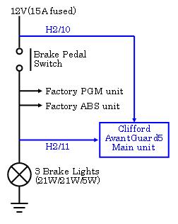

Please help for Advantguard5 brake light wiring.
They are written in a manual as follows:
  • H2/10   BROWN / red brake   light (+)12V input
    This is the polarity source for the brake light output and must be 12volt constant.
  • H2/11   BROWN / white brake   light input/output
    This wire powers the brake light circuit with the 12volt circuit only on H1/10 when activated.
So I confused about H2/10 wiring.
Which of "brake output" or "constant 12V", must I conected it to?
I expect that I must connect it to brake output.But I'm not confident about it.
In other words, do I cut off brakes circuit and let a clifford circuit interrupt there?
(Please see an attached fig.)
Regards.

No interupt. H2/10 goes to +12V constant, and H2/11 just taps into the brake light positive.

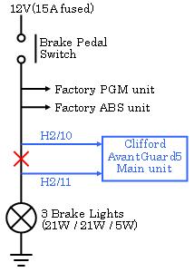

I made a mistake about H2/11 sorry.
It's written in installation guide as follows.
    This wire powers the brake light circuit with the 12volt circuit only on H2/10 when activated.
Thank you cosmoworks!!
Do you mean as a following figure?
Even if I have mistaken about H2/10, do you still mean a same?

My doubt was completely settled.
Thank you.
