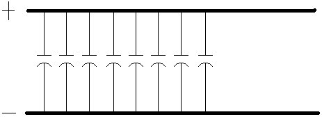

i have a system that is 500 rms and i need to make the voltage stable
please tell me or direct to build this
note(1): i am using 72 amp  car battary in standard family toyota
note (2) since i am nebwie i may not understand very complicated diagrams please let it be clear
thank you for reading...

my problem is to building a capasitor by connecting small capacitors with apropriate diagram
in other words i wanna make the capasitor that is sold arround for 200 to 1000 $...

A "stiffening capacitor" will NOT fix a low current situation (and this is what it sounds like you are trying to avoid/fix) The ONLY solution is a higher current SOURCE - which is your alternator.
Otherwise, capacitance is additive when paralleled, all you need is a crap load of smaller value electrolytic capacitors. Remember, that if you decide to go this way, the number of smaller caps will be HUGE, and the number of hagher value caps will be smaller, but their cost will be higher PER cap...
Tha math goes like this:
1,000,000 microF / 10,000 microF = 100 capacitors in parallel.
1,000,000 microF / 2200 microF = 455 capacitors in parallel.
Here's the diagram:
voltage stabiliser diagram -- posted image.
Just continue this same example until you get all 455 of those caps attatched to that printed circuit board, and let us know how FREAKIN' HUGE it is when you get done with it, OK...
My suggestion? Go buy the "stiffening cap" if you are REALLY bent on getting one, but my first suggestion still stands - you need an ALTERNATOR FIRST!!!!!

When I was younger and stiffening caps were new to the market I couldn't afford one. So I found some large-bodied high voltage caps and wired them all in parallel, taped them together, and voila! I had 2F of capacitor at the ready. I think I paid like .50 each for them at an electronics oddity warehouse.
