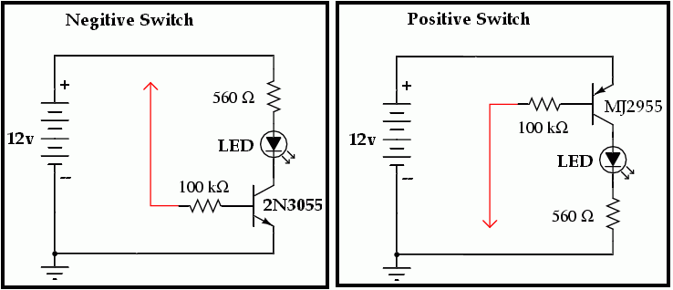

SCR?  solid state relays -- posted image.

I am slightly confused on the diagrams where does the load connect?
I will be feeding whatever I use with a fused 20-30 amp circuit.  Then the unit will feed the trailer plug in.  The truck wires will be used for the trigger.
I don't see where the higher current would come into play here?

Ok thought about it some more, I need a circuit that will switch the positive with a positive trigger.
I am thinking it will take two transistors to do this right?
I think I need to use a positive switch for the load with a smaller transistor as a negative switch to get my positive trigger changed to a negative trigger.
Am I on the right road here?
'03 F-250 CC Fx4

Yes you are on the right track.
And the Light Bulb is the Load

What would be a suitable smaller transistor to use for the trigger, since it will not have the current flow the load will.
