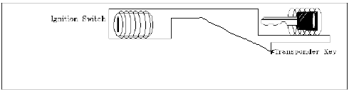

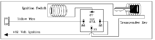

I just now noticed a remote starter installation manual that instructs you to wrap one end of a peice of wire around your ignition switch and the other end around a key, and connect the two ends of the wire to a relay.  When you remote start the car is completes the connection and the car thinks that the key is in the ignition.  If you werent concerned about the immobilizer feature (which I'm not), then couldnt I just wrap the wire around the key and the ignition lock and connect the two ends of the wire (eliminating the relay)?  There is no power sent to 30 and 87 connectors on the relay anyways.  Here are the instructions i found.
Transponder interfacing using relay:
If the vehicle has a transponder system installed, you will need to by-pass the system
while the vehicle is operating under the control of the Remote Start Unit.
To do this:
1.You will need a transponder key that's already programmed to the vehicle.
2.Remove the trim around the ignition switch.
3.Wrap a thin (28 - 30awg) wire tightly around ignition switch 6 to 8 times and secure it.
4.About 6"down line make another loop of approximately 2"diameter.
5.Place the key inside this loop and secure it to the loop.
6. Connect on end of the (28 - 30awg) wire to pin (87) of the relay module.
7. Connect the other end of the loop wire to Pin (30) of relay module.
8. Connect the pin (86) of the relay module to the ignition wire from the ignition switch.
9. Connect the pin (85) of the relay module to the H10/11 yellow wire of 20-pin
connector.
2WSS-AS on 2002 Nissan Sentra SER Spec V -- posted image.
Would this then also work?
Please let me know what you think!

The DEI 556U is just the newest version of the 555U, they are essentially the same. Provided your car does have an immobilizer system either one will work. It simply is a pre-made wire coil with a relay all packaged into a neat black box which can be well-hidden under your dash. If
your car requires this immobilizer bypass you will have to place a key into the module permanently, or at least until you remove the remote start or sell the car. One last note: in order for your local Nissan dealer to code a new key to your car they must have all the keys you have for the vehicle, including the one installed into the 555/556U. Keep this in mind especially if you only have two keys, you may want to have a new one made before you put in the remote starter!
