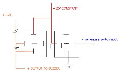

PS this will cause the buzzer to go off whenever the ign is turned on then turned off. You will then have to hit the momentary switch to shut it off.
PSS, I am waiting to be shown up here.
