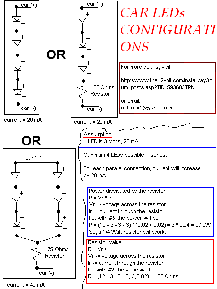

a_l_e_X1
Member - Posts: 11
Joined: July 01, 2005
Posted: August 01, 2005 at 11:44 PM / IP Logged
Hardwiring LED's -- posted image.
Hope it helps (and doesn't confuse you more, :D)
Alex
customcarchris
Copper - Posts: 95
Joined: July 08, 2004
Posted: August 02, 2005 at 10:51 AM / IP Logged
I don't agree with that picture very much, the first image would be ok if your LEDs matched ok.  The second one has the resistor on the negative side, you need the resistor on the positive side before the LED series.  The third picture has the LEDs in parallel with one resistor, this should be avoided in case LEDs don't have the exact same voltage, one will light and others not and then the one will burn out.
The second image is the most useful, but put the resistor on the other side of the series, on the positive side of the first LED.  The second most effective way is just one resistor and LED, then you don't have to connect the LED legs together if they are far apart.
