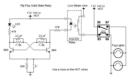

That my friend is a tall order.
This is a solid state version
Latching circuit for fog lights -- posted image.
The 12v would be hot all the time and the output would hook as a switch between the fog light relay  and the low beam wire.

Thanks for answering my tall order.  I thought you guys sounded pretty smart here.  Will this remember the state of the fogs after the vehicle is turned off?
What transistors should I use(do you have a number)?  Also, what is the AQZ202 relay?  I don't do much with electronics.  Would I be able to get everything from say Radio Shack?  How much do you think all of this stuff would cost?

The relay stayes latched until you put a pulse on it again.
When the lights go off you just drop power from the contacts of the relay. The relay will stay energized but nothing will go thru the contacts untill lights are turned on again.
The only problem  see is a  drain on the battery if you leave it turned off for a few days.
Just about Any NPN Transistor will work. 2n2222 comes to mind .

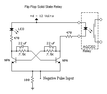

Just incase here is a modified circuit so you can know where the pulse goes.

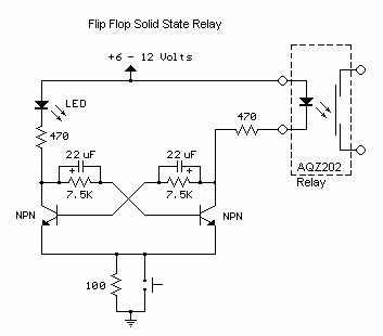

What happened to the low beam wires on the last picture?
I have DRL on the truck, and they are the low beam lamps without any park lamps or rear lights on.  I think the DRL use the same wires as the low beam lamps.  Is there a way to do this with a positive from the high beams to shut the fogs off?
How much drain will there be on the battery.  The relay will be energized all the time if the fogs were on when the vehicle was turned off?  Can this be done without the relay coil being on all the time?  Could you put another transistor in there somewhere, and use it to turn the relay on when the low beams are on?

The last picture was from another project. It is just a latching relay.
The circuit will get much more complicated as we add features to it.
