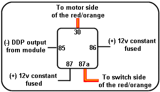

Does this diagram work for Reversal Rest At Ground for my 1995 camry driver side unlock system. i know the wire is
Drv Door Unlock   BLU/BLK   IN DRIVER KICK PANEL
Reversal Rest At Ground diagram -- posted image.
I am trying to make it so when i unlock once my driver unlock and press is two times it unlocks all the doors..

u will have 2 wire into the pass door for 2nd door unlock......

I dont understand so can you explain in little more detail
