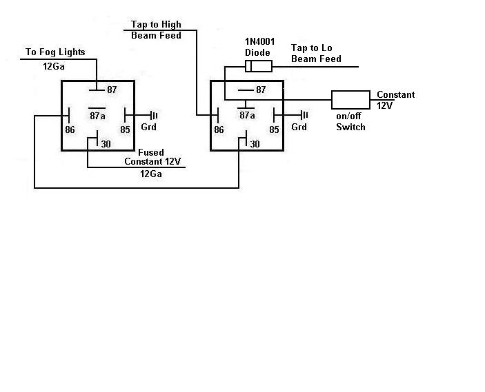

I  have seen a few good diagrams of wiring foglights on a car that never had fog lights. My question is, is it possiable to wire fog lights in a car thats never had foglights,and they work off the low beams, and go off with the high beams,ANd have a switch so you can have the fogs on alone in the daytime?

This should do what you want.
fog lights -- posted image.

Thanks for the info. Just what I needed....:)
