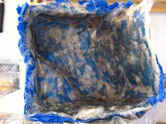

Day 2: Things are going much better now, unfortunately, some of the dammage done cannot be reversed!
I have found that cutting the fg mat works a lot better for me, if I would have started with this I am sure that I would have much less bubbles in my mold, ultimately I should need less layers if I have less bubbles right?
It looks as though the mold is pretty hard in most places, I am going to go over a few sections in an hour or so, I want to let it harden more before I assume that it isn't hard enough yet!
I hope that I have fixed the problem where I didn't mix in enough catalyst by spreading a bit of new resin overtop that had the correct mix, then glassing over it numerous times.
I am going to try and post a pic here, so let me know if I am still screwed or if you think she'll hold up!Resin Mixture &  working fg matt size -- posted image.

Posted: July 28, 2005 at 7:55 AM / IP Logged
It looks like you got a good mold. I would suggest cutting those bubbles open though and filling them with some resin or something. So that you dont have them cracking. It will be worth time now, to fix it, than finding out later it busts wide open. This is what I did im sure you can get one at walmart.  I took a little syringe, "with no needle of course". I cut a small hole in each of the bubbles. Then I mixed up a batch of resin and sucked up the resin in the syringe and forced it into the bubbles and it filled all the little small cracks and air spaces. It worked pretty good actually.

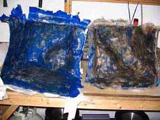

This is how much better I am getting at this stuff
If you can't tell, the pic on the left is the newest addition, I am looking forward to making these things look sexy.
I like to refer to it as giving my car breast implants, thanks for your help so far everyone, I really couldn't and wouldn't do it without the wealth of knowledge on here!

realitycheck
Silver - Posts: 751
Joined: September 09, 2004
Posted: July 29, 2005 at 7:17 AM / IP Logged
Significant improvement there dornstac, if you notice practice really does make perfect. Good job man!
