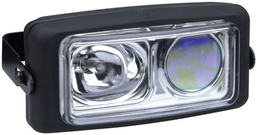

Fog Light wiring -- posted image.
ok here's the deal, I want to wire soe fog lights to my factory fog light harness.  My factory has 2 slots a positive and negative side.  The fog lights has 3 wires coming from the back; a red, white, black wire.  Any idea how to wire this.  The lights are dual lens w/ mirror lamp.  There's a pic of the fog lights.

You have 2 lights in that housing: a fog and a driving. The fog lamp is the one you want to hookup to the factory harness. The driving should be hooked up to be on only with the high beam. Probably should use another relay in there
