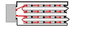

Chris Sr, if you haven't already left the building....use the parallel and series wiring calculators on the left column of this page to figure quad coil wiring.  If you were to use series/parallel wiring, the total load would be 1.5 ohms onto one amp (each sub's coils in series to 6 ohms and then four subs in parallel to make 1.5 ohms).
This would be what it would look like:
Subwoofer Wiring Configurations -- posted image.
Most mono amps have two sets of terminals, so you can wire two subs to one set and the other two subs to the other set.  The amp will parallel the pairs of subs for the same final result (see DYohn's response above).
If you intend to use two amps, use the calculators to find that you can make a 3 ohm load onto each amp.  You will still need to use mono amps because of the low impedance, and this choice might be more suitable if your single amp isn't able to handle such a low impedance as the 1.5 ohm shown above.  The power would be the same in either case, because 3 ohms is double the impedance of 1.5 and each amp would put out half the power that the single amp would into the 1.5 ohm load.  This solution, however, depending on the amp quality and the integrity of the MA coil measurements, will be easier on your system...sound better...and last longer.
