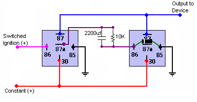

Right - what about this? This is what I think should happen. Can anyone please check this and make constructive comments please?
Momentary break? -- posted image.
When IGN is hot, constant flows through relay 1 to the device.
When IGN goes low, constant switches to NC (87a) and output is sent to relay 2 via a 2200uf cap, which delays the coil by about a second?
Once C1 is charged, relay 2 constant is switched to output.
When IGN is returned to hot, both output lines are temporarily hot but R1 bleeds off C1 and closes the link to relay 2?
So, overall operation is that when the ignition key is taken out, the output line drops to 0 for half a second then flips high again. When the ignition key is returned to the car, output stays high but resets itself ready for the next cycle.
Questions are:
Will C1 (2200uf 63V) be ok being hot all the time the car is parked 24/7?
Will having constant hot through relay 1 and 2 for a short while when switching the igniton back on give me any problems?
Do i need a clamp diode on relay 1? its a direct feed from car battery via a 10A fuse and ignition switch, no delicate circuitry.
Thanks in advance to anyone that can understand the diagram enough to help :)
