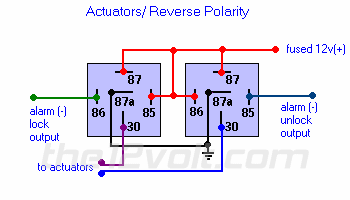

Im doing a 1992/8 Ford Flare side truck and need to know how to hook up the power door locks.  They are pink / YELLOW and pink/green, both rest at (-) .
I tryed this relay set up and all i got was shorting, obviously the wrong relay set up.
1993 Ford Flare Side door locks -- posted image.

just do the regular 5-wire reverse pol for each unlock and lock.

Ok, so do i go directly into the driver door to do this, or do i just cut the pink/green and pink / YELLOW in half say in the boot of the drivers door? Or do i have to actually cut the wire's in half between the door lock motor in the door and the switch?

cut the objective wires in half and use a 5wire relay for each.

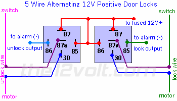

Like dis....1993 Ford Flare Side door locks -- posted image.
If you blow a fuse....switch 87a and 30....
