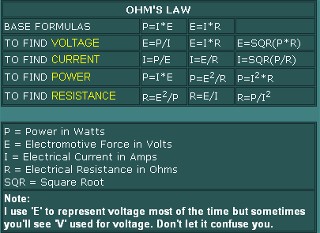

Tegpilot, use Ohm's Law to figure it out.
Using Test CD’s -- posted image.
To find voltage, E = SQR( P X R ).  R is the ohm load, P is the watts you want to achieve.  (When deciding on what formula of Ohm's Law to use, first determing what two known factors you have.)
For example, I set my gains recently on a mono amp with a sub that has a 200 RMS rating.  So I wanted 200 watts (as long as the amp will achieve that, which it could).  The sub is a DVC 4 ohm, wired in parallel, so the load is 2 ohms.  Using the formula, 200 watts X 2 ohms = 400.  Use your calculator to find the square root, which is 20.  So 20 is the voltage I wanted to set the gain at.

thanks man, "it all makes sense now"  *kickin myself in the head*  wish I would known that years ago! haha  So on the flip side, reverse equation, I can find out how much my amp is putting out in watts in all reality!  Sweet.  Thanks man, you made it easy to understand, more so than a graph that's left unexplained.
