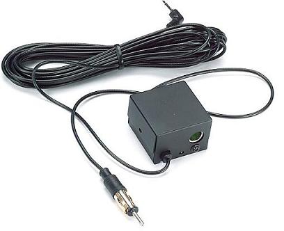

yes, easy as cake, but the modulator will cost him $20, as well as two antenna adaptors for the European radio plug. each $20. so it will cost you $60 just in parts alone. the Audiovox Switching Box will work with the XR9 and will turn on and off when the power to the XR9 is turned on and off.
2002 BMW  X5 FM modulator? -- posted image.
http://www.crutchfield.com/S-brWkEidgESx/cgi-bin/prodview.asp?i=220SATSWB&s=0&cc=01

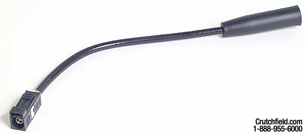

with a OEM male to standard female:

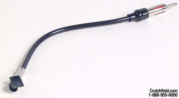

and a OEM female to a standard male:
