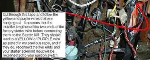

I have some pics of my wiring.. hope you cna make sense of them..

Are they the 2 wires right next to each other there? The purple one.. and the yellow one with the white wire joined to it and cut?
Just connect those 2 together?
Thanks so much for helping.. seems so simple.. but I would have never figured that out!

Alarm was stolen, how do I fix my wiring? -- posted image.

Ok.. so if I understand this correctly.. there will be one wire that was cut -- interrupted -- and I just need to reconnect it... and it will be yellow OR purple..... not connecting yellow to purple..
Thanks again for your help.. sorry if I am making this more complex than it is..

Yes, it will be YELLOW or PURPLE.  However, from the picture it looks like the installer used a yellow and purple wire to extend the factory starter wire, then once he wrapped the ignition harness, butt-connected those two wires to the alarm brain Starter Kill input/output (the white Starter Kill wire is still attached to one of those).  So assuming that is all correct, you could just connect the two that are hanging out, but that may be a risk based on pure speculation.  I have performed hundreds of installations, and feel confident about my recommendation, but I would definitely unwrap those wires and confirm that they are in fact the starter wire before you make any connections.  You can test the switch side by metering it for 12V+ while turning the key to START.  If the other end is the same color (again, on a 1984 Blazer, it could be YELLOW OR PURPLE), then connect them as securely as possible and your truck will crank.Alarm was stolen, how do I fix my wiring? -- posted image.

Ok.. more problem here...
I took all the black tape off that thick bundle of wires..
The yellow wire with the white tip connected seems to lead all the way to the fuse block.. it doesn't seem to connect to another wire..
And the purple wire leads all the way up to the neck of the steering wheel column.. I don't see any other wires that it is connected to..
So do I just connect the purple wire to the yellow wire?
A couple things of note though.. before the CODE-Alarm was put in this truck... there was another alarm in there.. I believe it was a Clifford alarm. So there could be stray wires in there from that install too.

It worked!
It's running! You did it! I connected the Yellow wire and the purple wire and it worked. The starter turned over and it started!
