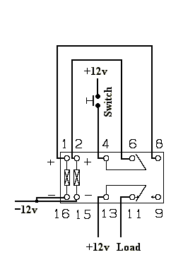

Right i have bought the following latching relays
[img]https://i4.photobucket.com/albums/y144/monkeyMera/diagramlatchingrelay.jpg[/img]
Right, ive got some push button switches that are really nice but they are push to make and when you let go they break the circuit, not good if you want to switch something on and leave it on ie, Neons ( yes i know they are  :ghey:  and chavy) AMPs etc
i was told i need some latching/sticky relays so i bout the about as i was told that is what i need but i dont know how to wire them up
the switches have 2 terminals and i want to beable to press the switch and turn somethnig on and then press again and turn it off. can some one help me out please
i can solder very well and i know where to buy parts i just dont have the technical knowledge to design it
as far as i know that relay is all i need to do what i want, i dont need it to calculater the pressure i pused the button and decide what to switch on it just needs to switch on and off from a non latching push button switch.
i want to go down this route cos i got some sexy switchses for a next to nothing price a while ago and i want to use them, i couldnt find a latching type that looks the same. (there probably is out there and cost the earth cos i want them) i dont need to get all technical with PICs transistors etc.

hotwaterwizard
Silver - Posts: 1,350
Joined: December 11, 2003
Posted: August 24, 2005 at 12:05 AM / IP Logged
Another Latching Relay Thread -- posted image.

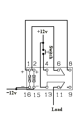

hotwaterwizard
Posted: August 24, 2005 at 12:14 AM / IP Logged
Here is a Revised PictureAnother Latching Relay Thread -- posted image.

Cheers for that, would i be able to put the load on pin 9 as well?
hotwaterwizard
Posted: August 25, 2005 at 8:55 AM / IP Logged
Yes you could.
You could alternate loads if you wanted.
