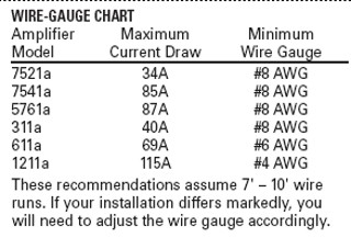

Yes, note the text under the gauge box.  The longer runs result in some voltage drop, whereas the short run from the distro wouldn't.
RF distribution block: wire size? -- posted image.
If the distro didn't come with fuses, you can use up to 100 amps for each 8 ga. wire, but at least match the total fuse rating of each amplifier.
BTW, notice some discrepencies in Infinity's wire gauge chart?
