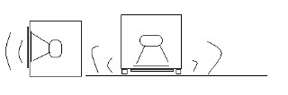

stevdart
Platinum - Posts: 5,816
Joined: January 24, 2004
Posted: September 15, 2005 at 7:36 AM / IP Logged
Woofer sag -- posted image.
.......Front-firing....................Down-firing.........
exdox77
Member - Posts: 35
Joined: May 31, 2005
Posted: September 16, 2005 at 4:44 PM / IP Logged
your not really going to be more bass, actually it would be like being in a bandpass box. but you would really get lower spl, but may be beneficial if you are a SQ guy. you could filter out noise from the speaker and other stuff like that. in theory you wouldnt really be very beneficial but thats my suggestion

Fosgate3
Copper - Posts: 328
Joined: January 29, 2004
Posted: September 25, 2005 at 7:53 AM / IP Logged
One of the benefits that I have found in a downfire arrangement is that often, the vehicle's floor carpet/padding acts acoustically with the output of the sub, helping getting rid of standing waves and crap like that. I really enjoy the sound that a properly made downfire enclosure does. I have experimented with various heights-from-the-floor and found that 2 inches really does well, 3 is fine, higher seems to make it sound different to me. As most of us probably know (for the benefit of those who dont), the sub has to have some distance between it and the floor in order to give a good output. For SQ purposes, as was previously stated, IMO, downfire is one of the ways to go, if your application allows for it. For SPL, IMO, I would not recommend it. Just as the carpeting acts acoustically for an SQ application, it can "take away from" the output of the sub if your are trying go SPL.
