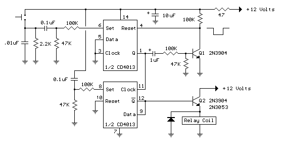

I have Installed and Repaired Stereos for years. Most need atleast 10 amps to operate. Show me a schematic diagram of one of your nifty Flipflop Circuits that will handle 10 amps continuous current that is not complicated.
Here is one I have
project ? -- posted image.

You're name wouldn't happen to be Bill Bowden, would it? I only ask because I stubled across this page: http://ourworld.compuserve.com/homepages/Bill_Bowden/page9.htm. This guy has 'your' circuit posted there and claims the credit for it.
Any digital IC chip is going to need a dedicated driver circuit (transistor). The D series flip flop will use the same transistor output as 'your' JK flip flops in the circuit you posted.
My circuit below does not have a debounce component, because I don't have the time to add it. You could do it several different ways, but the easiest would be an RC setup and a buffer.
If it were me doing it, I would use an Atmel Tiny11 microcontroller. They cost $0.50. They only downside is that they operate on 5vdc, so a voltage regulator and a few caps will be necesarry. But, they have built in pull up resistors and you can software program the debounce. You will still need the transistor output.
Here is the D flip flop circuit that requires no code or programming. Please note that this is a 'simple' bare bones circuit. If I were building it I would include a few more resistors to control the current flow in the base of the transistor and out of the collector of the transistor.
