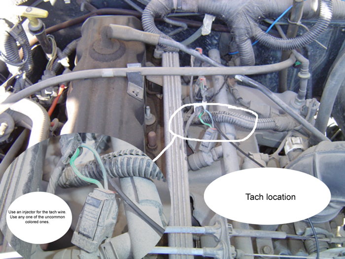

Velocity Motors
Moderator - Posts: 12,488
Joined: March 08, 2002
Location: Manitoba, Canada
Posted: September 20, 2005 at 8:46 PM / IP Logged
Use the injector instead. Work for me 100 % of the time. Above is a pic of a Jeep engine and the injector wire will be anyone that is uncommon between the injectors.
