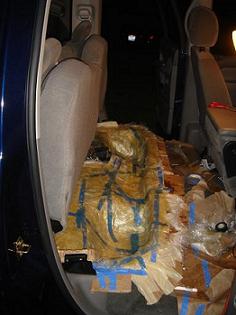

thanks guys, i am almost done with the box (its going to fit in the cargo wells in my 04' dodge quad cab) here is a pic of what i have done so far, i plan on putting a flat MDF pice that i have already cut to shape on the top. any ideas on how i should
attach the fabric to cover the top to the fiberglass, i was thinking about glueing small wood strips to the actually fiberglass so i can staple and stretch the fabric to them.
thanks

looking good so far, shuld trun out sweet as

what kind of subs are you going to be using? I have a friend that wants to fiberglass his ram the same way but is
not sure of the airspace

I am using two 12" RF Punch stage 1's but they are not hitting that good, i would suggest getting something that handles at least 200w RMS
