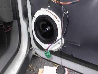

Seems that these are lacking some mid punch. I like to play my music very loud and think that I have taken to much out of them to get where I want as far as SPL goes but I still want SQ. I do intend to dynamat the doors. Can I add a box or something similar to encase the mids to help the situation? Seems that I have seen some styrofoam(sp?) baffles that mount behind the speaker, would these help?

First things first...and that is to get the door damping done.  Use Dynamat, Dynamat Extreme or equivalent, cover both skins (outer door and panel).  Seal all holes.  Also, if you haven't done so, make a MDF baffle mount for your mid driver.  Install the driver on the baffle, then install the baffle in the door.  The all 'round improvement in both SQ and SPL will be extraordinary.
example of baffle install:
Pro60 mid bass -- posted image.
The only baffles behind the driver you might consider after that would be for keeping weather off the speakers.  But even then you should cut out the back end so that the sound waves can travel throughout the door void.  I avoid that approach, myself.  I haven't been faced with a situation where the windows leaked so badlly I needed to cover the speaker.
