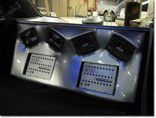

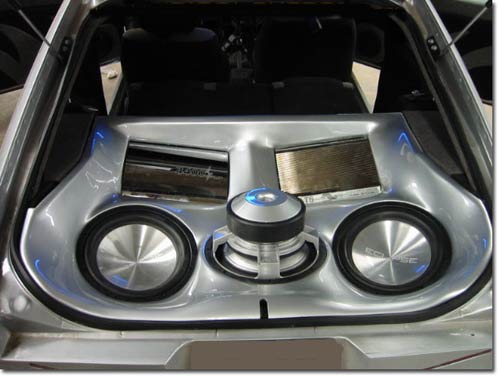

what materials aside from mdf to start a foundation will i need to build a custom 4 12' sub box the current space is the entire third row seat of a 04 explorer xlt. so if anyone can tell me what materials i need i will attempt to make something like this for learning purposes and well if it comes out good use it if not garbage.
I want to achieve making something like this similar to this but 4 sub mounts and 4 amps in a rack
What materials do i need for this? -- posted image.

fiberlgass, resin,body flier,fleece, and lots and lots of time

fiberlgass, resin, body filler, fleece, and lots and lots of time
Forgot sand paper, sand paper, patience, and sand paper. You also need wood, but that should be a given.

so in what order do these materials go stage wise
1. wood
2.?
3?
4?
5? still dont know What materials do i need for this? -- posted image.
and also is there anything that i have to mix? or is everything pretty much buy it and ready to use?
and my last one any local stores that will carry these things and if so named brands you recommend thanks

In the case of making a FG enclosure the stages are usually: wood, a few coats of fg, filling, sanding, primer/filler and more sanding.  The FG is 2pac so u will need to mix the resin and hardener 2gethor, bog/filler is usually 2pac aswell so u mix the hardner with the filler.  Home Depot sells prety much all the stuff u wuld need, auto shops will proberly sell the fibreglass and bodyfiller awell
