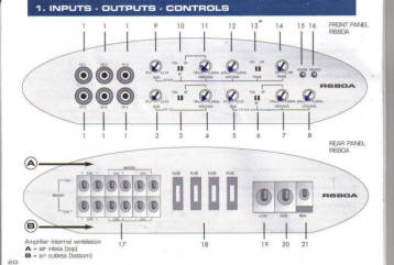

what i will do later,is take pics of the amp.mainly the side wall where all the switches and settings are.i will write up the spec's of the comps and also the woofer.i would do it now but my sister has my car.i will take pic's also of the headunit and the display it has for hpf and lpf.as for the amp and lp or bandpass switch,i dont think the amp has a setting for lp.i remember seeing hp and bp.i will check though when she gets in.if she ever gets in!! never lend a car to anyone else,they will muck it up further than you have.especially if its a woman.

hpf and lpf, which setting? -- posted image.

i managed to upload this pic.sorry it is very small.limit of 30kb on it.i think if you right click and save pic you may get a better view with a picture viewer.

i have checked the control panel on the amp.no lp switch at all.there is however a knob which i can select the required lp.these are the same knobs which are used for the gain control.above in the pic you will see where i have added ink to make arrows in each section.where all the arrows point to,this is the way the amp came,and im wondering which direction all these arrows should be pointing to.
                            (1).rca inputs   ( 2).input gain control  ( 3).operation mode selector(slide switch to select highpass or full range operation of the active crossover for channels 1/2)   ( 4).high pass crossover frequency control    (5.)input gain control    (6.)operation mode selector(slide switch to select highpass,bandpass or full range operation of the active crossover for channels 3/4   (7.)highpass crossover frequency control(to adjust the cut in frequency of the channels 3/4)    (8.)low pass crossover frequency control (to adjust the cut off frequency of channels 3/4)   (9).input gain control    (10).operation mode selector,(slide switch to select highpass,bandpass or full range operation of the active crossover for channels 5/6)    (11).highpass crossover frequency control,(to adjust the cut in frequency of the channels 5/6)   (12).low pass crossover frequency control,(to adjust the cut off frequency of the channels 5/6)  (13).slide switch to activate/de-activate the phase shift control feature of channels 5/6    (14).phase shift control   (15).operation l.e.d   (16).protection l.e.d    (17).terminal block   (18).fuses   (19).12v connection   (20).ground connection   (21).remote lead "in"

That looks like a capable amplifier, very versatile.  The bandpass setting would be used for the subwoofer output.  HP allows passage of highs, or anything higher than the setting (of course, it "cuts" it off on a curve);  LP allows passage of lows.  So LP is used for the subs' high point and HP is used for the front and rear speakers' low points...AND the subs' low point.  (LP is not used for the front or rear speakers.)  The settings between the two should be the same:  i.e., if 80 Hz is used for the sub's LP, then 80 Hz should also be used for the main's HP.
If the GT4s are housed in a sealed box, turn the HP as low as it will go.  If the subs reside in a ported box, you can use the HP setting as a subsonic filter and put it just below the box tuning frequency.  If the HP setting won't go as low as 30 Hz, then this amp is not suitable for driving subs.
The disadvantage with this amp/subs combo is that the subs are SVC 4 ohm, and so they will have to be series-wired to 8 ohms to bridge across channels 5 and 6.  This may be too little power for the impact you are looking for, so perhaps a mono amp (with the subs parallel-wired) would be a better way to go.
The phase/shift slider can be set to whichever way makes the subs sound louder with the rest of the system playing.  Experiment with that.
