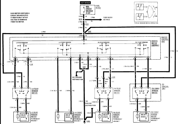

91 Buick Century Power Window Problem -- posted image.

hopefully this will help it is the wiring schematic for your car.you've done quite the work for a novis. if you need help pm me and ill see what i can do. lol
