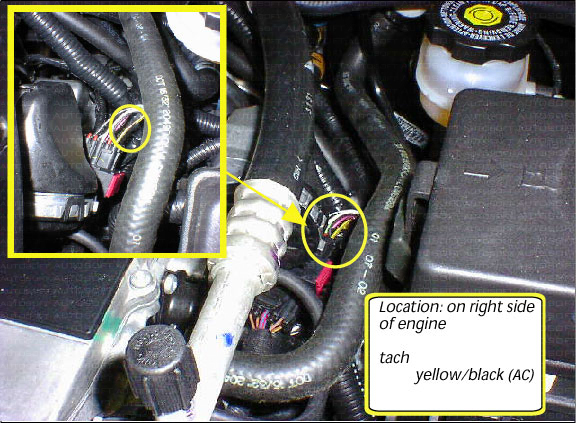

Posted: October 25, 2005 at 9:41 PM / IP Logged
Here is a pic of the location of the tach that I use.
Jeff
