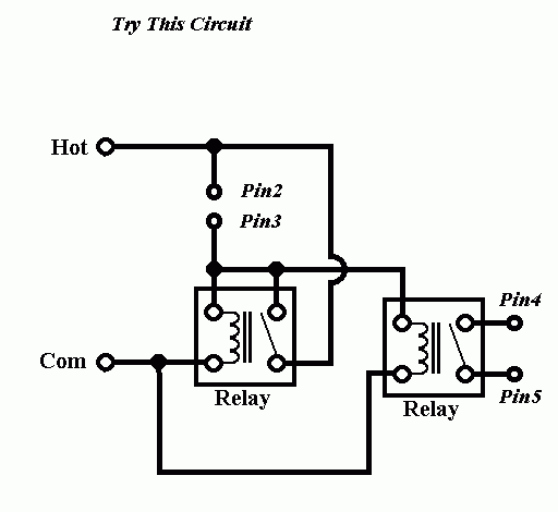

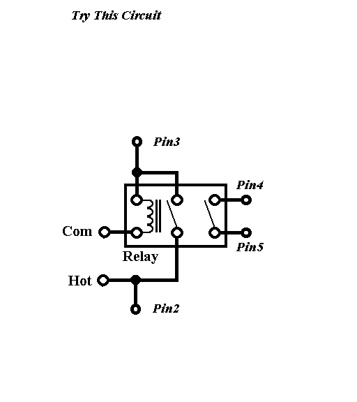

Ok I have a six pin DIN connected to a device with the following properties:
Relay Dry Contact Closure (Pins 2 & 3)
When the accessory relay is energized, its contacts
close and present a short across pins 2 and 3 of the
connector. The relay contacts are rated for 10 watts,
maximum at 28 volts dc/ac rms. Within the limits of
the 10 watt rating, the closed contacts will handle up
to 750 milliamperes continuously and will switch up to
400 milliamperes of current.
Relay Closure Timing Control (Pins 4 & 5)
Pins 4 and 5 of the accessory connector are used to
select the time duration of the relay contact closure.
If these two pins are NOT used (open circuit), the relay
will remain energized for approximately 10 seconds after
an alert is received. If pins 4 & 5 are SHORTED, the relay
will remain energized until the 'RESET' button on the front
of the device is depressed. Pressing the 'RESET' button
causes the contacts to open and turns off the ALERT indicator."
I need to have a 24volt steady output when the device is energized and turn off with the rest button, what circuit do I need to make for this to happen?
Thanks for any help!

The Question is loaded to mean more than one thing.
Do you want it to have 24v after the reset is pushed?
Before and After?
What about the Time Delay on or off?
Be more specific.

Posted: November 10, 2005 at 12:03 AM / IP Logged
Relay setup -- posted image.
USE 24v RELAYS For this circuit.

hotwaterwizard
Silver - Posts: 1,350
Joined: December 11, 2003
Posted: November 10, 2005 at 12:07 AM / IP Logged
IF you use a DPST Relay you can use only 1 relay. LOAD OUTPUT Will connect to pin 3
