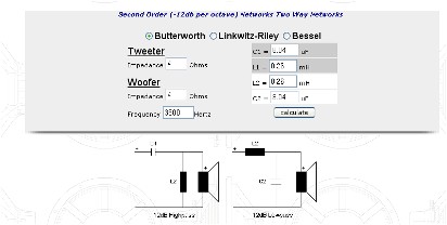

It would be far simpler and probably about the same cost to just replace those factory speakers with coaxials that are already supplied with a mid/tweeter and tiny 1st order crossover.  The quality of the mid alone will most likely be much improved.  But, if you do want to try your hand at something new and gain a good learning experience, you can make the crossover yourself with parts from an audio retailer.
Here is a link to a crossover calculator  http://www.mhsoft.nl/spk_calc.asp#crossover  Since you don't know if the tweeter is 4 ohm or otherwise, you'll have to assume that both drivers are 4 ohms (if you can obtain a meter to measure resistance let us know).  Go to the 2nd order crossover and input type Butterworth and enter 3500 Hz, with each driver entered as 4 ohms.
tweeter getting hot -- posted image.
You will see values given for caps and coils (inductors) and a diagram for each of the two drivers.  Find the values of the caps here http://www.partsexpress.com/webpage.cfm?&DID=7&WebPage_ID=72
...and the coils here http://www.partsexpress.com/webpage.cfm?&DID=7&WebPage_ID=313
Note:  these are the cheapest types of these components available but would be suitable for your project.  (But they are actually higher quality and handle more power than the typical crossover in a store-bought speaker system).  Now draw up your diagrams and put these values into it, selecting the value that is closest to what the calculator came up with.  With this info you can go locally and pick up the parts.
