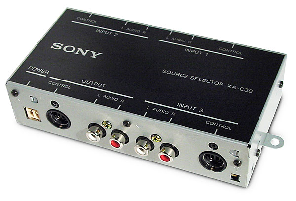

http://www.crutchfield.com/cgi-bin/S-jt8UA2DFEjB/ProdView.asp?a=0&s=0&g=62700&id=detailed_info&i=158CDXMP30
It appears as if you have an optional aux input for which you need the Unilink adaptor? XA-C30 Retail $100.  Or you need a compatible Sony Unilink device.

How to add Aux Input for Sony CDX-MP30 -- posted image.

Actually, not XA-C30. It's used to transform the original single changer input on the Sony receiver into 3 selectable changer inputs.
I know, that XA-107, or XA-300 seems to do this job, ie, adapt the CD changer input on Sony receiver into an extra Aux input as well as retains the CD changer input.
