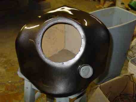

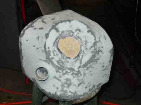

this next pic is after i used bondo to fill in the dips and pits

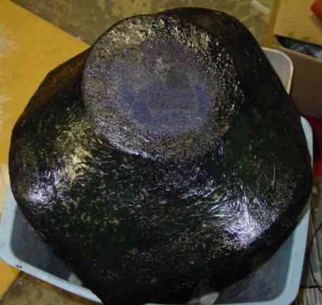

as you can see there is a tweet pod there that is actuly made out of a tolet paper toob that convineanently fit the tweeter perfictly. i added the role by cuting it to fit the box and then i glassed it to the box buy useing strips of mat and buy riping it up and spreading it on as needed
some of the bondo is a mix of filler and resin so it is pritty strong so that adds to the strenght of the box.

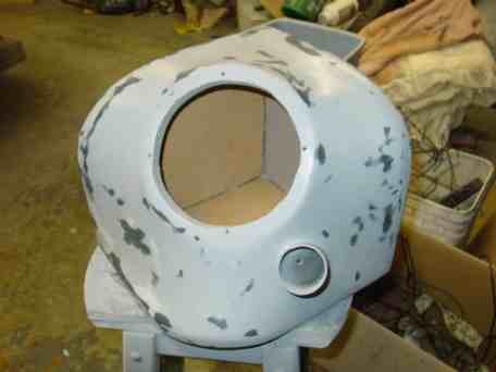

this nex pic i have goten most of the sanding but there is still more to do to get it smouth. it was really hard to sand the groves in the tweet pod but in the end i got it done.

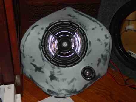

this one is the pic of the speaker and tweet instaled in it i gust wanted to see how it sound you know how it is you gust have to try it i culdent help my self i gust had to try it. i drilled a hole in the fg were the wire from the tweet had to go into the box to get conected to the extensoin wire. and then i drilled a wire through the back of the box so i had a place to run the wires out to my amp.

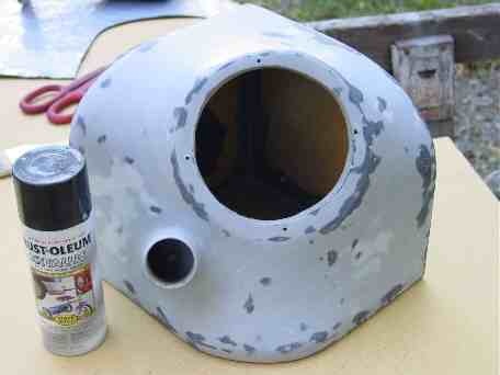

this next pic is of the finesed sanded box next to the paint that im going to use a matalic gunmetal paint that as you can see in the next pic that it did a good job for being a spray paint.
umm nice it looks very good for spray paint after i put the base coat on i put a clear on that gives it that shine. i have all the tools to do a car paint on it but i gust wanted to keep it sinple (so i though). i really am looking forwerd to useing the air gun on it iv done some cars but not a box it will be interesting

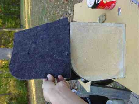

this pic of the back mdf that i am puting a kind of carpiting on it looks pritty good it blends in with the other colors
