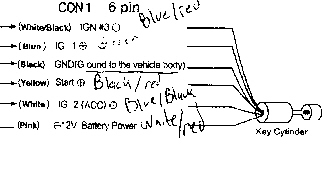

OK, I am trying to wire up a Alarm/remote/keyless entry system (air wolf two way remote car starter)The Wiring diagram that i got for my 2001 Mitz elipse says that the following:
12v Constant: WHITE/ red
Starter: BLACK/ red
Ignition 1: green
Ignition 2: Blue/Red
Ignition 3: n/a
Accessory: blue/black
Ok, as you can see in the image i have attached, it calls out for an Ign 2/acc, and a Ign #3, tell me if i have this configured right?2001 Eclipse, alarm/remote start -- posted image.

GREEN is only IGNITION
2 Accessories......BLUE /Red & BLUE / Black

so your sayin, i should hook green up to both ing wire, and put both BLUE /Red & BLUE / Black to the acc wire?
Or i should probably just pick one shouldnt i?

NO ...........Only the GREEN wire needs to be powered as IGNITION 1
There is NO need for ignition2
BLUE /Red & BLUE / Black are powered as Accessories
